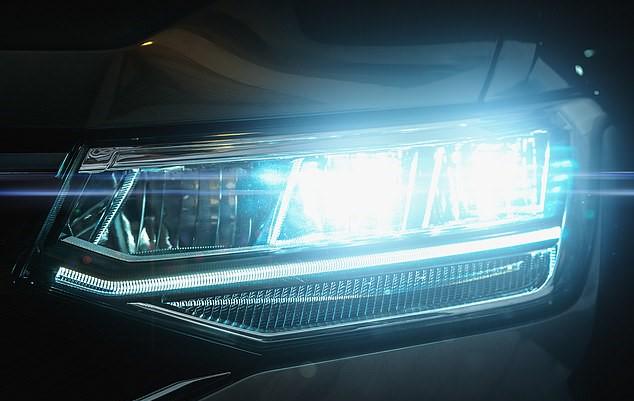

"It is said manufacturing cars companies will develop certified LED upgrade kits, so that you could change your headlights without fearing any legal problem. Although people believe this law is nonsense, these kits could be a great solution for road safety. Even though we can’t notice it, lenses that are different to the original car system could have some malfunctions."
I guarantee you OEMs are NOT developing LED upgrade kits for their older vehicles. They spent a lot of money back when to certify what is already there. And to lead it off with "It is said" tells me that the whole paragraph, nee the whole article, is supposition without any references or sources. Sounds and reads like foreign-produced clickbait to me.

But to make them physically fit a light assy socket, doesn't make them right...
The main issue still is the way too high, unnatural light color and wavelength...
Where H4 lamps emit around 4000K (hence neutral), are automotive LED always offered with 6000K (cool) and beyond, which causing dazzle and glare, regardless if their complete OEM head/taillight assy's, or brand/pattern retrofits...
Same happened on household light fixtures and bulbs, the first LED's where just awful, gray/blueish tone...
Took them a couple of years till the finally toned them down to a warmer spectrum, which is halfway natural, thus more comfortable and acceptable to the eye...
