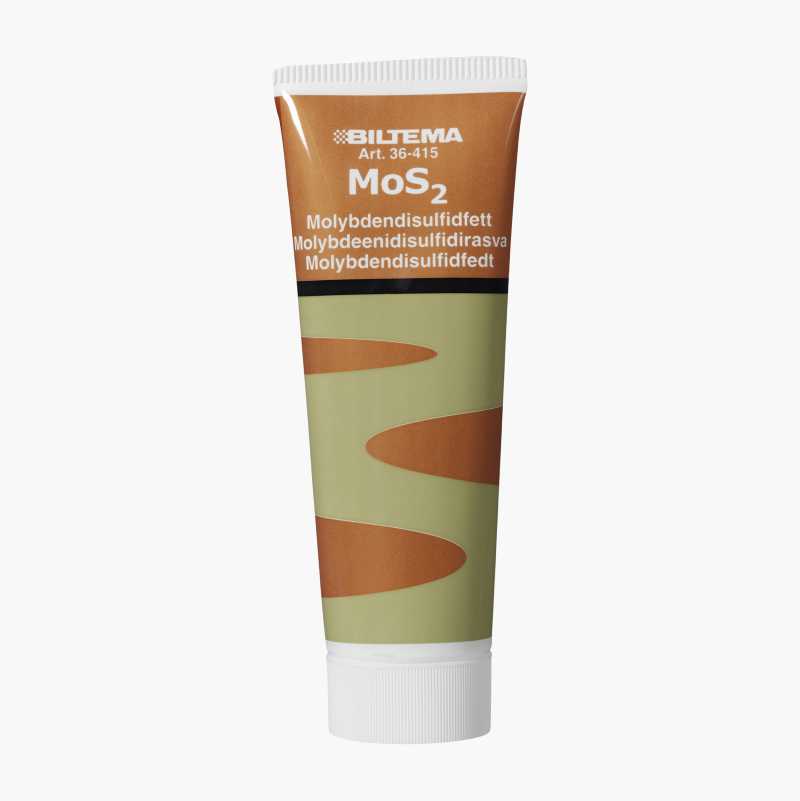

There are different recommendations locally for Loctite 8012 where an ST1100 owner has driven 140,000 kilometers and used Biltema's Molybdenum disulfide grease MoS2 without any problems. A BMW owner has tested several types but says the best is Klübergrease Staburags NBU 30 PTM. Another thinks Honda M-77 MOLY 60 is best. I don't know but I would assume you think Loctite 8012 is best for ST1100 …
Which grease were you using when your splines failed?
Mine look fine at 190,210 statute miles. Always used the original Honda Moly 60. I’ve been on the three ST forums since 1998 and know of many failed rear drive spline failures because of non-spec lubes. But do whatever you want, I won’t comment further.
